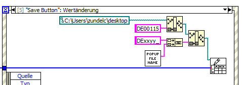

I tried to realise this in the VI i attached.
The drawbacks i encountered are :
 _ the user can't chose where his file will be saved ( i can't get the system directory to appear AND to chose a part of the file name)
 _ The data is gathered in my 1D array but when i open the file created (when i dont put any input in the "path" of Write to Spreadsheet) it is empty
 _ Even when i write a full path directory (which i think is correct) i get an error
Do you see what's wrong with this code? Is there another way to do what i'm looking for?

Hi Clement,
there is a "Save button" event in your event structure, but we miss the subVI in that event…
Attach your subVI and we can talk about your problem!
We cannot see your subVI so we cannot comment this item…
Your case structure ahs a "default if unwired" output tunnel, that could cause a lot of trouble…

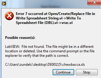

Which error  do you get?

This is the error i get when i :
 _ reinitialize the values
 _ run the VI
 _ click the GO AUTO button
 _ wait for the graph to be completed
 _ click Save button
 _ agree to name the file
That might be because i misunderstood the block VI : does it not create a file if the path does not lead to an existing one ?
You have to ensure the file path exists before you can write a file into that path.
Make sure the folder(s) exist(s)!
On your filename creation problem:
NEVER use strings to build paths! Use path constants and path functions!
