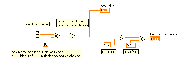

Hello Dan,
 Well i have implemented the frequency hopping in SIMULINK. i created a logic and implemented easily in the simulink. Here the frequency base is 5.7khz and the frequency jumps after every 512 hz.i have used NCO aslo called DDFS to generate frequencies. the frequency hopping block is created by using Pn sequence and converting the binary no to intergers then multiplying the integer with the jump which is equal to 512 and then added with the base frequency which is 5700.it will give u the next frequency to hop on. for example if we get the interger 3.we multiply it by 512 i.e 3*512 + 5700 =723. so how to implement this logic in labview?

The logic to generate your hopping frequency is quite easy in LabVIEW (see picture).  I am not sure how you are interfacing with your device however, or what kind of data it takes in so I'm afraid I can't provide any more detail about getting data at this frequency into your device.
