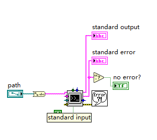

hi,
I use System Exec.vi to exec my bat file. my question is how to get the vi standard input in bat command.
I wanna use vi standard input as bat's parameter.
thx!

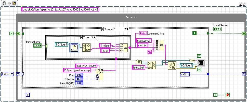

So you have a parameterized batch file? Try passing to System Exec+ the file path with the correct parameters concatenated on the command line.
Another possibility is to create (using file output functions) and run another batch, complete with parameters, that will run the first one.
Paolo
LV 7.1, 2011, 2017, 2019, 2021
(4,104 Views)
Build the command with all the parameters you need line and put it in a batch file, then run the batch file
Here is an example
