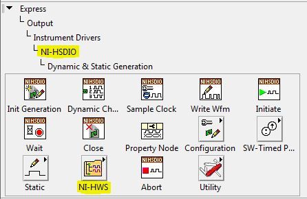

You can create .hws files with the NI-HWS VIs. If you missing this palette then install the NI-HSDIO Driver.
With the NI-HSDIO Driver you get also a bunch of LabVIEW examples.

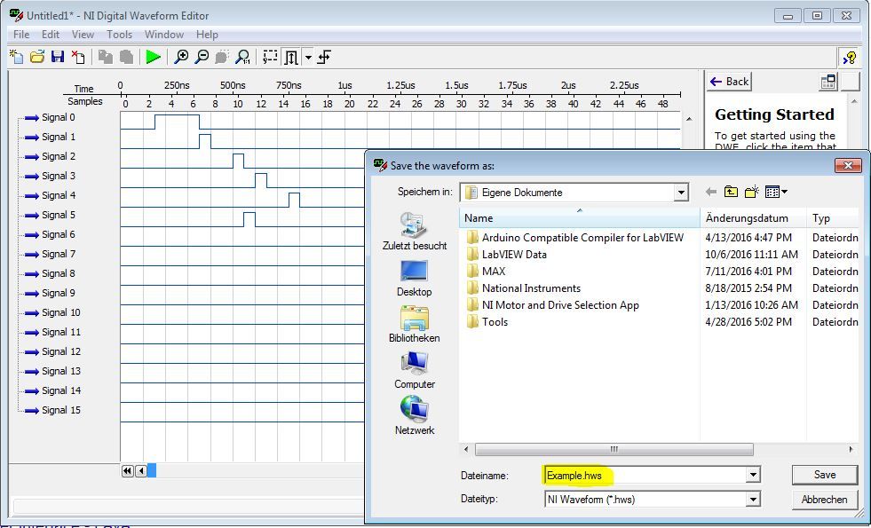

Alternativ you can use the NI Digital Waveform Editor to create the Digital Waveforms.

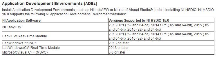

For the following languages is a NI-HSDIO driver support available. You need the NI-HSDIO driver for the PXI-6541 (you can find that in the NI-HSDIO readme):
Additional you can use Signal Express for NI-HSDIO (SignalExpress is a interactive software for quickly write out some signals to a NI devices, with no programming required) or you can program the board in native C.
You find the C examples after the installation of the driver here:
C:\Users\Public\Documents\National Instruments\NI-HSDIO\examples\c
With the listed Software above you can programmatically create a pattern and play the pattern on the PXI-6541. With Signal Express you can play the pattern but you cannot create programmatically the DIO pattern.
I'm not familiar with MATLAB® but it looks like that other guys have created a .hws file with this tool.
