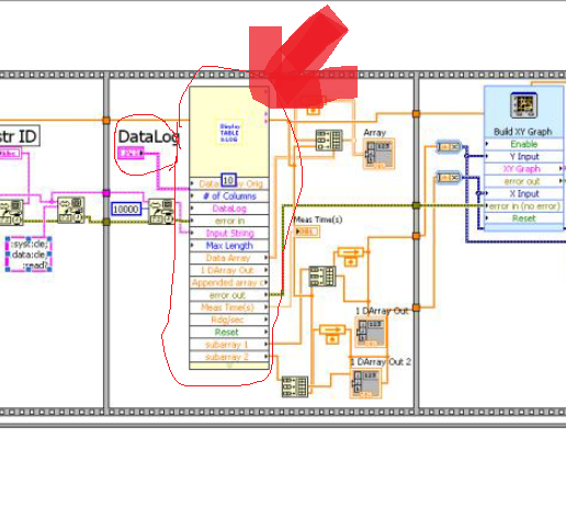

how can I create the icon on block diagram by the following image?
I want to create the icon which marked by red pencil  and include with Data Array Origin, # of  columns, Datalog and others like the upper figure but I can't find any icon that specified with this icon. I think may use from File I/O or String  in Programming on block diagram. Please give advices to me if you can find the icon like this. Thanks for all your suggestions.

The Icon which is not actually an ICON, its an express VI converted to a Standard sub VI. You can create one by yourself by searching for "Express VI" in LabVIEW help.
It could also be a normal VI which has the "View As Icon" unchecked.  I commonly see this when the connector pane gets "crowded".

You are correct. I should get intouch with LabVIEW programming more often. 🙂
