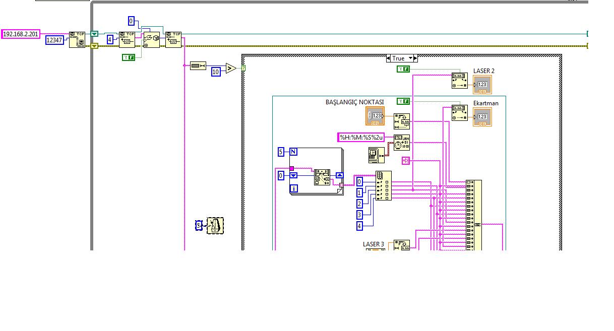

Actually my real problem is that real time is working 8 milisecond to 20 milisecond(interval) for sending datas but datalos.vi is reading 9 milisecond and this is working when RT is working at 8 milisec, when my reading rate is less than RT sending rate  i see my system is starting to loss datas

i don't realy understand your question but if you are trying to read tcp port continuously you have to synchronise read and write loops. so you won't miss data. you said your crio sending data at different rates may be you can try to add a register to send your rt send rate to adjust pc log rate.

   Have your problem really solved?If not you have to use the synchronisation vis which are present like notifiers,semaphores etc.Please let me know how you have solve your problem if it was solved.

I solved my problem but i didnt use syc tools.Fisrtly you can use same until wait time for  tcp send loop and receive loop.For example; tcp open must wait 5ms and tcp write or listen must wait 5 ms.as.jpgs
