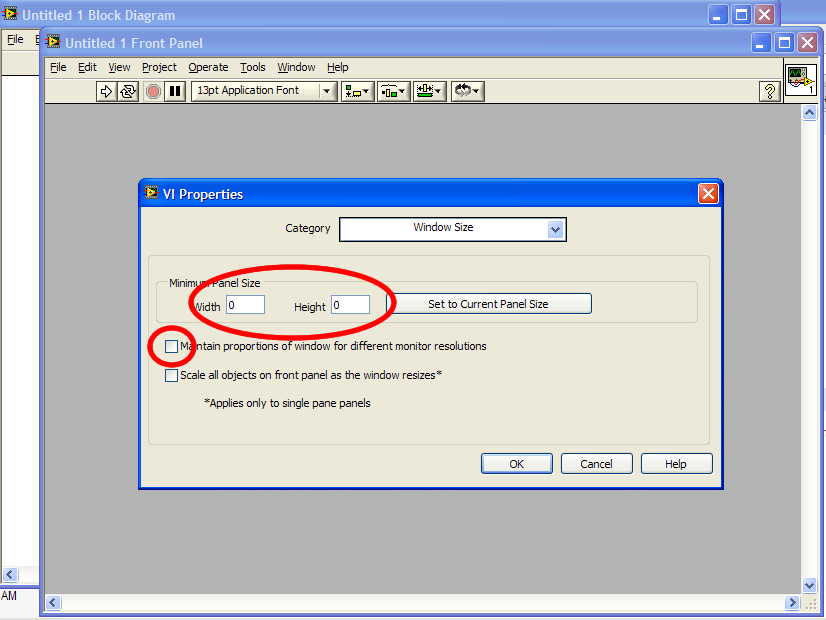

how can i set resolution my front panel to 640*480?
How can i set resolution my front panel to 640*480?
i want my resolution front panel after created to  (.exe file) be 640*480.
i setted with VI Properties Section,but is changed?
please help me.
Thanks.

You will need to do exactly what I think you said that you tried but you will also need to check the box just below the setting see image.

as aeastet said, make sure you're keeping proportions constant.
Also make sure you're not SCALING the panel.
You could also get a reference to your VI, use that to get a ref to the PANEL, and set the panel size, all from your program.
Don't see why that would be needed, though.
