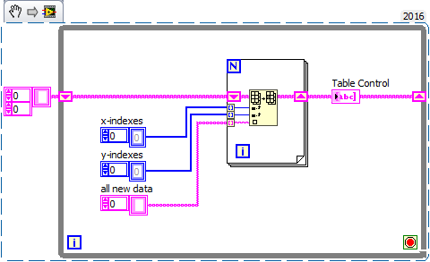

sorry i shouldve used the word "display" instead of "storing"... incoming data is in hex and and i need to display the hex string(specific bytes) in a specific column of the table.
i have posted the screenshot below... cannot capture the entire code it is placed within a while loop...

Hi Sidkay,
- why do you use local variables like "element 2", when there is a wire available next to it?
- how often do you need to change the IndexVlas of the table?
- how often do you need to set CellValues of the table?
- why do you need to use Method nodes of the table instead of changing the table array data directly? (Use ReplaceArraySubset to change single elements in the 2D array!)
- why don't you use GetMatrixSize instead of ArraySize followed by IndexArray?
- you might use a DeferPanelUpdate property node before and after changing the table…
- why don't you clean up your code?
- why don't you close the VISA port after using it?
Posting images of code is quite senseless as we cannot debug images using LabVIEW. (Sidenote: you would like that with text-based programming languages either!)
When you can't post code because the VI is "too big" then you should think about modularizing your code…
Message 5 of 16

That picture does not help at all and you have not answered any of my questions. (size, etc.). What is the loop rate?
"Hex" is not a data type, all you have are strings, some formatted in decimal and some in hexadecimal.
As Gerd already pointed out, your VI is full of race conditions due to poor understanding of dataflow and blatant overuse of local variables. Your "element 2" local variable will get read before the "element 2" terminal has been updated, making the case structure operate on current data based on stale size. All you need is wire the "element 2" value across the selector terminal and make one case "default" and one case "15..". Right? Why do you think you need to take the array size twice and index it out twice in parallel? Are you expecting different results? Once is enough!

forgive me for my mistakes... i am new to labview... had recently done some changes to the code that's why had multiple instances of similar blocks... i have fixed those hopefully and cleaned up the code and replaced some blocks as well;since it was the better option; as much as i could...i hope none are left...
the table i have used is an indicator...
i need the index values to change with every new packet that VISA reads with every iteration but the loop rate is very low that it misses many packets by the time next iteration begins... i have used 6 instances of set cell value as i am using 6 different columns...
i tried using defer panel updates before n after the change as well but the execution speed was more or less the same as not using it... using that property node gives me the speed i want as it does not miss any packets but doesnt update the table until the VI has been stopped...

all your screenshots are so overcrowded - and look wrong (IMHO)…
Get rid of those SetCellValue method nodes. When you want to change values in the table you only need to edit the 2D array of strings which is wired to the table terminal!
Problems with your last image:
- again locals where you should use a wire instead
- lots of terminals with no (or hidden) label
- duplicated code belongs into a loop!
- hidden wires
If you would attach your VI we would have a chance to edit the VI!
But we cannot debug images using LabVIEW…

Sidkay, you are iging tooooooo much property nodes
Replace all cells and only then draw table
Message 9 of 16
(5,582 Views)
You cannot replace elements in an empty array. The SR need to be initialized with a 2D array of strings at the full final size.
