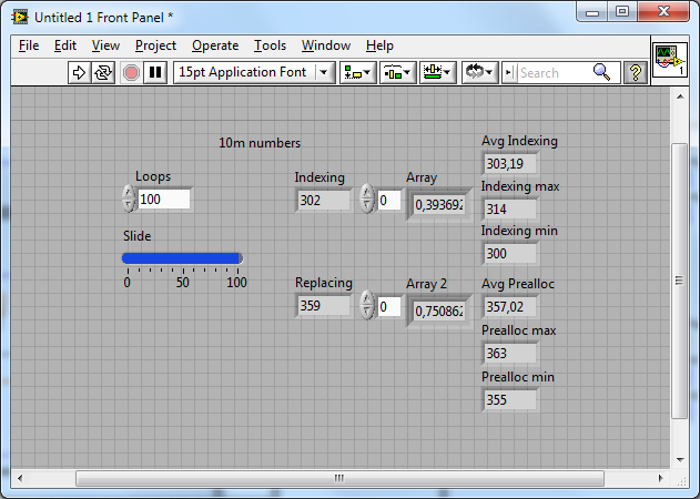

I did a small test program. 10 million random numbers build an array (*2), one through indexing, 1 through preallocation with Initialize array and then replace. Loop and rebuild 100 times and check the result. This is my result!
It might be affected by version and system, but automatic indexing is FASTER than Replacing a preallocated array. 🙂

You may be comparing apples to oranges. If you need to initialize an array with a single value, then the initialize array function and the for loop with a constant should take about the same amount of time.
Without seeing the code, I don't trust any benchmarks.
(Even with full access to the code, I take such benchmarks with a grain of salt).
At least show us the diagram or attach the program. 😉

Mah, i knew you'd say that. Ofc i forgot to save it, but this recreation is pretty identical (except the slider).

Yes, the difference is quite significant but probably not worth it. 80-90% of the loop timing is taken up by the random number generator, so if we subtract the time to generate the random numbers, the true difference is even bigger.
OTOH, we can see that any real computation will be significantly more dominant, making the empty loop differences insignificant in comparison. We would try to improve something that is only a very small percentage of any typical loop computation.
Interestingly, the autoidenxing loop has a bigger debugging overhead. Once we disable debugging, the differences are even bigger.
Results with an inner loop N=1000000:
autoindex: (69ms, 64ms*)
replace: (74ms, 72ms*)                  *second number is with debugging disabled

The main point is that the easiest coding is in this case also the fastest! \o/

Prior to LV 6i the preallocate and replace was faster.
As of LV 6i, a lot enhancements where implmented such that the For loop will preallocate the buffer when it starts and is slight faster than coding it up the hard way.
