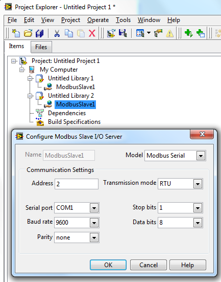

I have got a system that uses 2 identical Serial (rs-485) Modbus libraries on 2 seperate ports.
I can can put the 2 libraries on the same com port as long as I put them on different addresses.

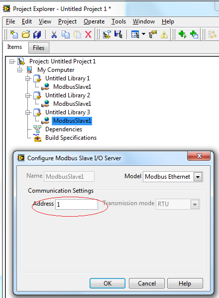

Unfortunately the same doesn't appear to be true for TCP/IP.
The best I can do is multiple masters but only 1 slave and they all have to be on the same address.
Add a second library on a different address and it all goes bad.
Any suggestions/solutions?

I'm not totally sure I know what you're talking about. Can you post screen shots showing how you are accomplishing this with modbus and screen shots of what you have tried for TCP/IP?

If adding as a slaveconfigure the master device with the IP address of the NIC that connects the LV MyComputer target to the deviceand you can host multiple slaves on that same IP and separate them using the slave address (as the dialogs you posted show). So long as your master device allows you to configure the unit id.

Unfortunately this is a limitation on our Modbus I/O Servers, as the Creating Modubs I/O Servers help article explains.

Currently Modbus Ethernet is only designed to work with one slave on the same computer.  If this is something you want to see implemented in future versions of LabVIEW, please submit a request to ni.com/ideas.
