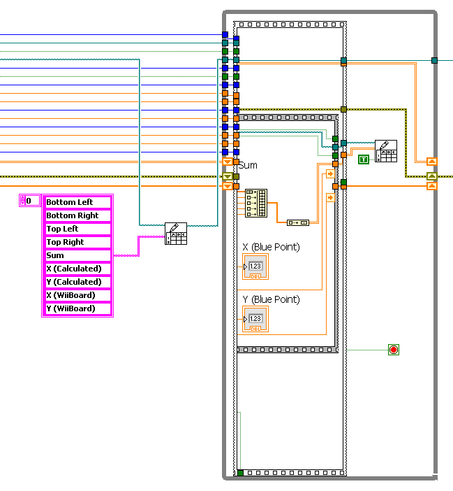

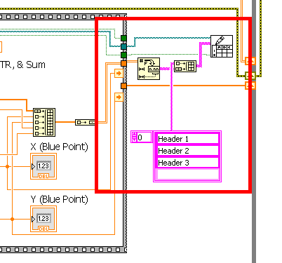

These are the functions I talked about:
This is really very basic, so you're going to have to learn how to do this. I suggest you try looking at some of these tutorials.

This is what it would look like:
Ignore the fact that I compressed the code in the loop. The important part is that you write the first row once before the loop and the rest of the data inside the loop (with the append input as T).
In general, this is very important to understand on your own if you expect to do anything in LV. I would strongly suggest you follow those tutorials and try learning from other places as well.
