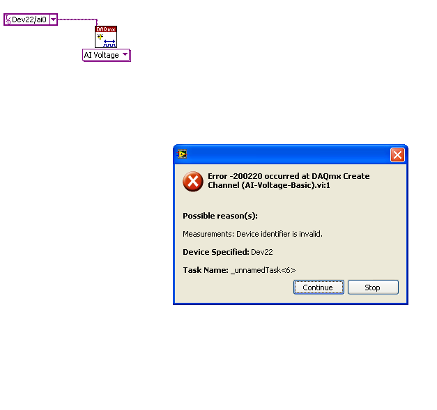

how do i solve this error while i run the program
how do i solve this error while i run the program?
Error -200220 occurred at DAQmx Create Channel (AI-Voltage-Basic).v:1

Hi
Are you sure that 200220 is the error code?
Can you get a screenshot of the error message and/or the code(Block diagram)?
Message 2 of 8
(4,075 Views)
That error is
Device identifier is invalid.
Message 3 of 8
(4,063 Views)
This error occurs if you are referring to a device that is not present at your system. If you are using a data acquisition device, make sure that you are referring to it as it appears under Devices and Interfaces on your
Measurement and Automation Explorer. There is no Dev22 on my system and this is why I am receiving the error as you can see on the image.

You can create a "virtual" DAQmx device in MAX and use it in Labview.
