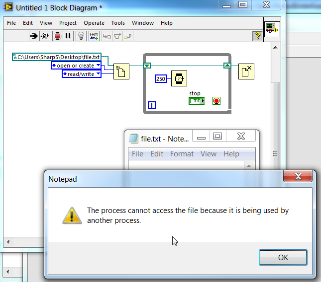

If you open the file reference at the start of your logging/application, and only close it at the end of the logging/application - your application will hold the lock on the file and no other application will be able to write to the file.
Here is an example:
In my VI (which you can see is running), it opens/creates a reference to file.txt and holds it open until I press stop. I opened the file in Notepad but if I try to save the file, I get the error you see in the screenshot.
If I stop the VI, I can then save in Notepad.
