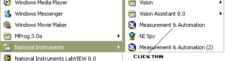

I am new to the software and in the prelim stage  Can u tell me how to find the max no:
Message 19 of 54
(2,344 Views)
Max = Measurement & Automation Explorer.
