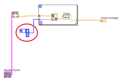

Did you check the number of elements in the circled array?

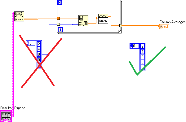

You are picking the rows. Change the Index wire to column inside the for loop.

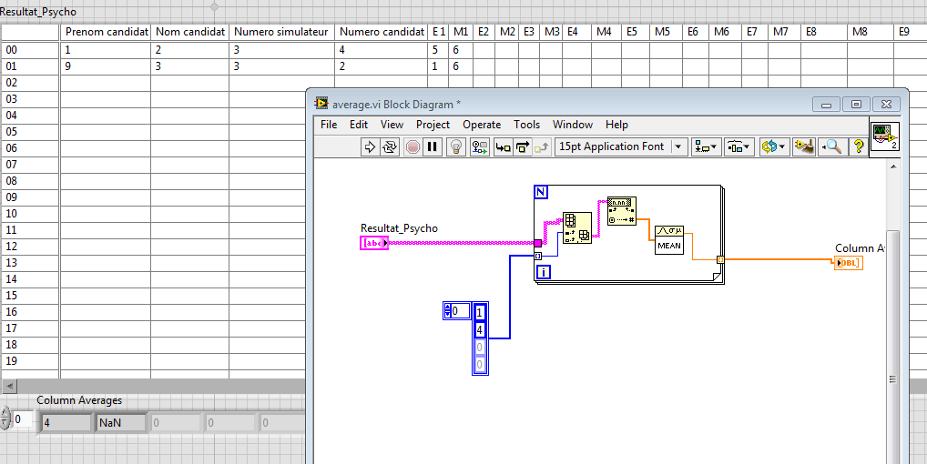

i already did it but nothing,maybe the mean vi doesn' t caclulate the average value

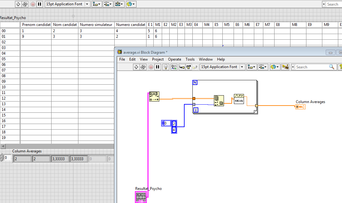

This is what I get.
Message 18 of 23
(1,446 Views)
that' the result that i wanna get,what is the difference between my vi and yours.the mean vi i guess Smiley Frustrated

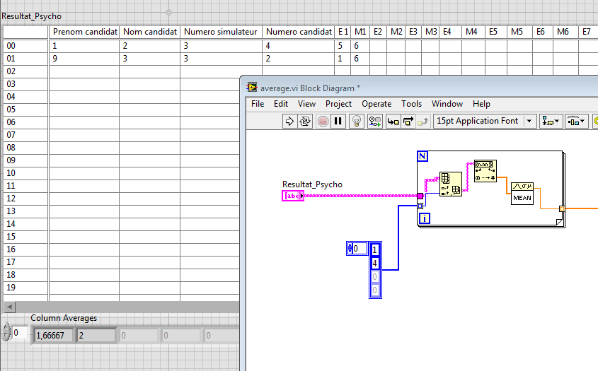

Post your latest VI.  There has to be something hidden that the picture is not showing.
