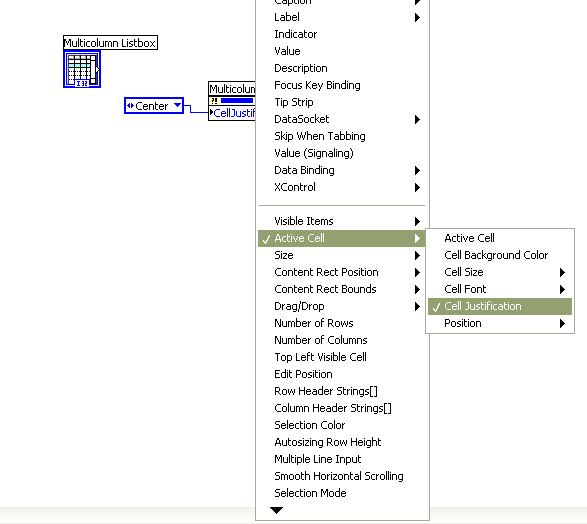

Using Property node

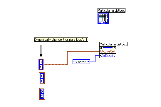

Please do it like this. If you select "cell justify" alone then the property will be set only for the first element. active cell is like a pointer. Change it dynamically using a loop.
