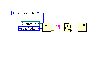

I have a file which has some  characters written into it, I want to clear the file how can I do this?
Say I have word called "LabVIEW" , I need to clear this word and final result should be empty file.
or I need to replace the contents by writing "NI" into the file, but when I do this I still find other characters from LabVIEW word.
Thanks in advance

But it does not work for me,
I tried this yesterday lot of times but was unsuccesful so posted here,

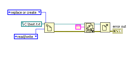

There is a difference between your method and mine. My method will move the EOF marker so that it gets placed after whatever I've written to the file, which in this case is the empty string. With your method the EOF marker is not moved. To perform the equivalent operation with your code you'd have to use the Set File Size right after the write function to set the file size to be the length of the string you wrote to the file. Or, you can just use the single function as I did.

Well this settings work for deleting the contents.17965i376C2257A9C8645C
