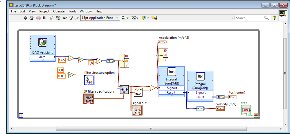

Your picture already shows something that is close. Did you write that? Can you explain what kind of remaining problem you have? (maybe units, etc.?)
As a first step, I would rewrite the VI to simulate some data with known result and get all the math squared away, then hook it back to the accelerometer.
  1. Please attach your VI instead of pictures. Picture hide a lot of information:
    • Are these charts or graphs?
    • What is the loop rate?
    • How many points do you get per iteration?
    • How is the raw data calibrated? Why do you subtract the mean? Is there an arbitrary offset? How does the signal look like before filtering?
  2. Explain what you think is wrong
  3. Explain what result you get and what you expect to get instead.
It might be clearer to do all math explicit without the use of express VIs, but in the end it should not make a difference.

I know what you said and I also used the "Initialize Array" function for testing. but the value after the integral is very large.

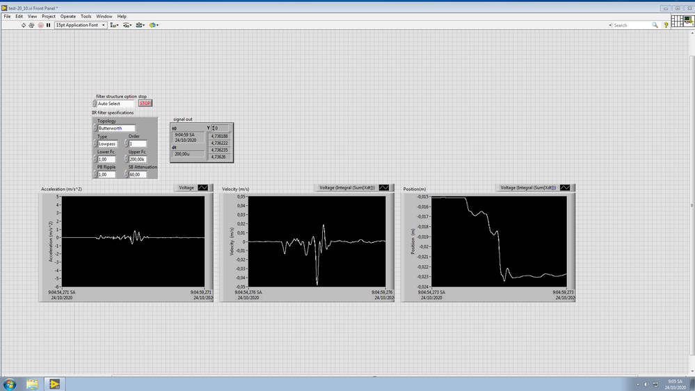

according to what I have learned, the integral of acceleration is acceleration, the integral of velocity is position. But when I integrate like that, the value after integration increases a lot, leading to the wrong value. can you help me check if i am wrong. below is my VI. thank you!

Christian suggested to replace that DAQAssistent by a know signal source, like a simple sine wave:
(I removed the loop for simplicity.)
I see two problems:
  1. initialization of the filter introduces an unwanted acceleration value.
  2. Subtracting a variable mean value in each iteration of your VI will also change the acceleration value in a non-predictable way.
The rest is pure and simple mathematics: a variable offset will kill your integration routines afterwards…

Does it increase with every iteration? Does it work correctly if you run once without the loop? Your first image shows a displacement on the order of a few cm. What displacement do you expect instead?
