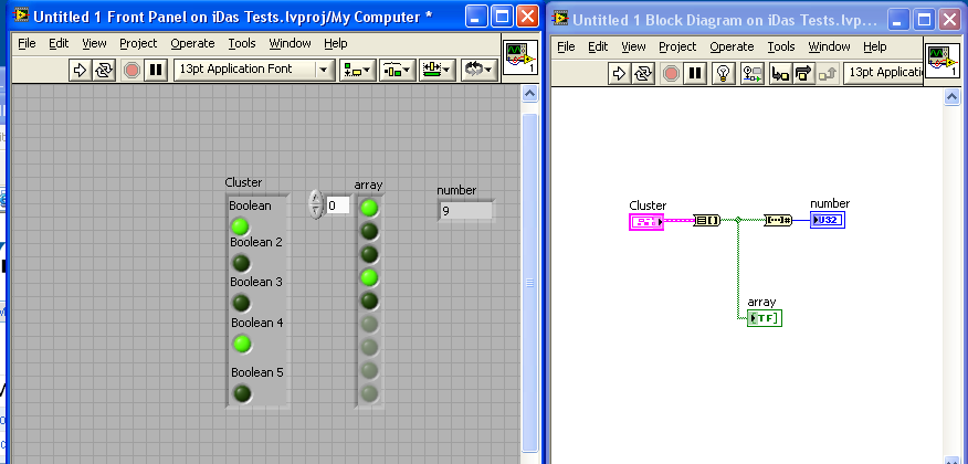

When you say a mass component, that isn't an array, do you mean a "cluster" of booleans? If so, there is a function that takes a cluster of identical components and converts it to an array.
If not then you will have to be more specific about what is meant with "mass component"

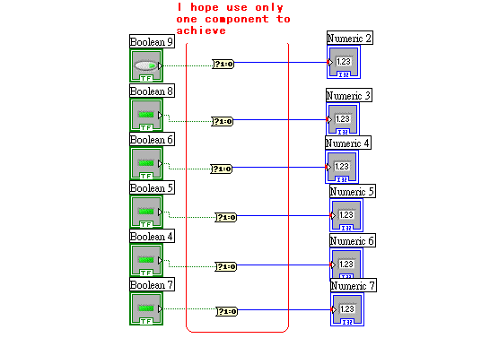

sorry , my question not clear
please check this attaching picture
I hava mass LED control component , I need to convert (bool to interger)
but I don't hope to plot mass line to achieve it
thanks !!

Still not clear.  You have 6 LED controls.  Each is a boolean, on or off.  You have 6 numeric indicators.  Each will show a 1 or 0 depending on the boolean.  You need to have the boolean to number for each wire.
Or are you trying to combine 6 booleans into one numeric indicator?  If so, put the booleans in an array and use the boolean array to number to convert it.  (That is what Putnam shows.)
Or you can use the Build Array function to take the 6 individual boolean controls to build it into one array.

Sure: you can wire the boolean array directly to the conversion node. The same could be done with the cluster, but you would obtain a cluster of integers as output.
