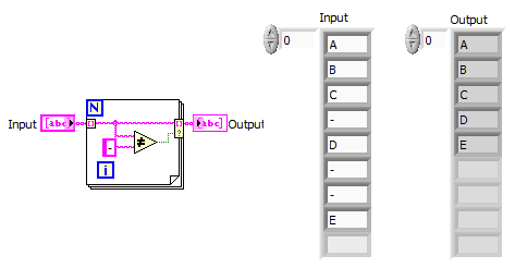

Autoindex you array using a FOR loop, compare with [not equal "-"] and use a conditional output tunnel.
Do you need help with that?
(2,368 Views)
Could look like this:
(2,365 Views)
