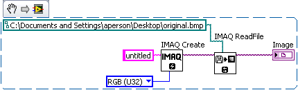

What you could use is the NI-IMAQ driver which is part of Vision Acquisition Software.  You can use the IMAQ ReadFile function and display it as shown below.  This WAS tested with original.bmp and was displayed correctly. It's not part of core LabVIEW but does do what you're looking for.

mmm2006 wrote:
Do you know whether there is a  way to resolve this problem?
All the subVIs of the bmp read function are fully exposed, so it would just be a matter of reading up on the bmp specs, adaping the code accordingly, and saving the resulting code under a new name. I don't know how much effort this would take and if there would be problems.
I have not tried this, but since Alex said that the vision drivers support 16 bit BMPs, that's probably a less painful way to do all this. 😉
