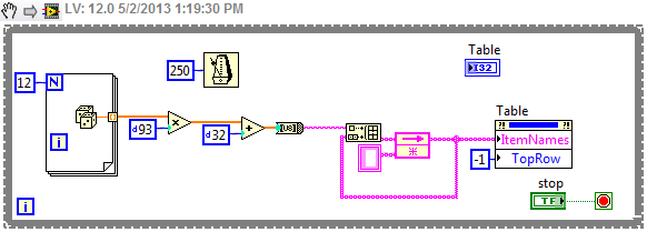

Hi, I am new to labview. Does anyone know how to display the recorded data whle append new data line by line in labview? The data type is string and I would like to use listbox or just string indicator to display the data history. Thanks in advance.

There are a lot of ways to do that but Here is one simple way using a listbox

The problem with Jeff's example is that is is always an iteration behind.
