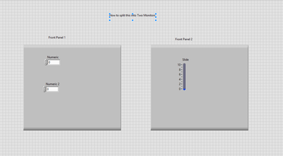

HI
I have attached one VI file .. How to split this ?

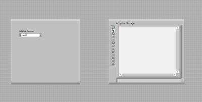

Accepted by topic author SaranVenkateshS
Like this

Apply the same concepts.
Have one VI pass data to a different VI.  I showed the way by using queues.  You could also pass references to controls form one ot the other.

try This ..

Hi Modification done with previous is after loop i  need to do close fp.
added modifed file below.
