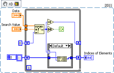

As Anand writes, Search 1D Array is definetly an option. But this works out for integer, boolean or strings properly, but not for floating point numbers directly.
But i doubt, that find(x) in MatLab can handle a float x properly without pre-analysis....
So if working with floats, you should do something like this:

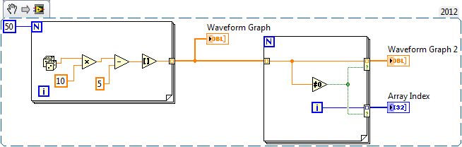

If you have LabVIEW 2012 you can use the Conditional Tunnel Mode to recreate the basic find(X) functionality. If yu don't have 2012 you will need to create the logic that builds the 2 arrays on the output of the For loop.
Array of non-zero values and index

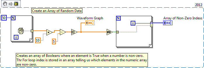

Here is another version my coffee induced creativity came up with:
Matlab - Find(X in LabVIEW) Rev 2

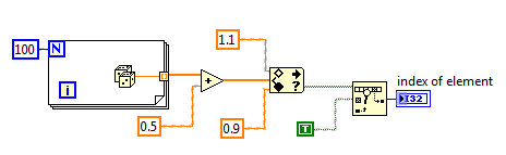

Or you could even do it this way:

Regarding the posted suggestions:
Please don't post code/images of code where you compare floating point numbers with direct equal or not equal functions. In most cases, it works, but not in every case (2!=2 might return true for instance)!
thanks,
Norbert

@DavidCorney wrote:

@Norbert_B wrote:
Strange PM.... would report that to moderators.
thanks,
Norbert
Maybe I am being dense, Norbet, but you lost me when it comes to comparing a floating point numbers.
In my mind a number is zero, or not zero, irrespective of data type and digits of precision. Why would the equal and not equal to zero functions fail with floating point numbers? If you are suggesting they should never be used with floating point numbers, that is going to confuse the heck out of a lot of LabVIEW users, especially the less numerically sophisticated (me).
Can you explain your logic in simpler terms for me? Thanks.

This
Norbert
