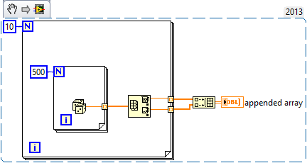

You don't need a shft register, just use the Max/Min Array function. In this example, I built ten 500-element arrays, found max & min for each, and put them into a 10-element (x2) array:
Should be easy to adapt for your application.
