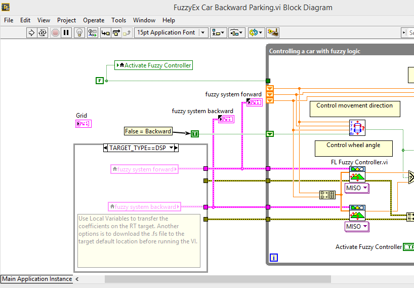

Then, the other options is demonstrated in the shipping example:
C:\Program Files (x86)\National Instruments\LabVIEW 2015\examples\control\fuzzy\Car Parking\FuzzyEx Car Backward Parking.vi
Here is the snapshot of it:

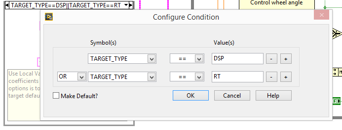

In here, although the options says TARGET_TYPE== DSP, this is also applied to RT targets too. To do that, you can change the taget to:
In doing this, you have to do the following to load your fuzzy logic system into the local variables. To do that, you need to do the following:
a) First, you need to load those local variables with your fuzzy logic definition. To do that, the easiest way is to just run your application on Windows (setup as the example above), which it will populate the locals variables "fuzzy system forward" and "fuzzy system backward". Then, you need to find those controls and, at the border, right-click to the control and use 'Data Operations >> Make current values". This will make the data permanent to the local variable.
b) Target the VI to RT. This will enable the code above and it will now use the local variables to load the code to it. This should be enough to make it possible to run this code.
