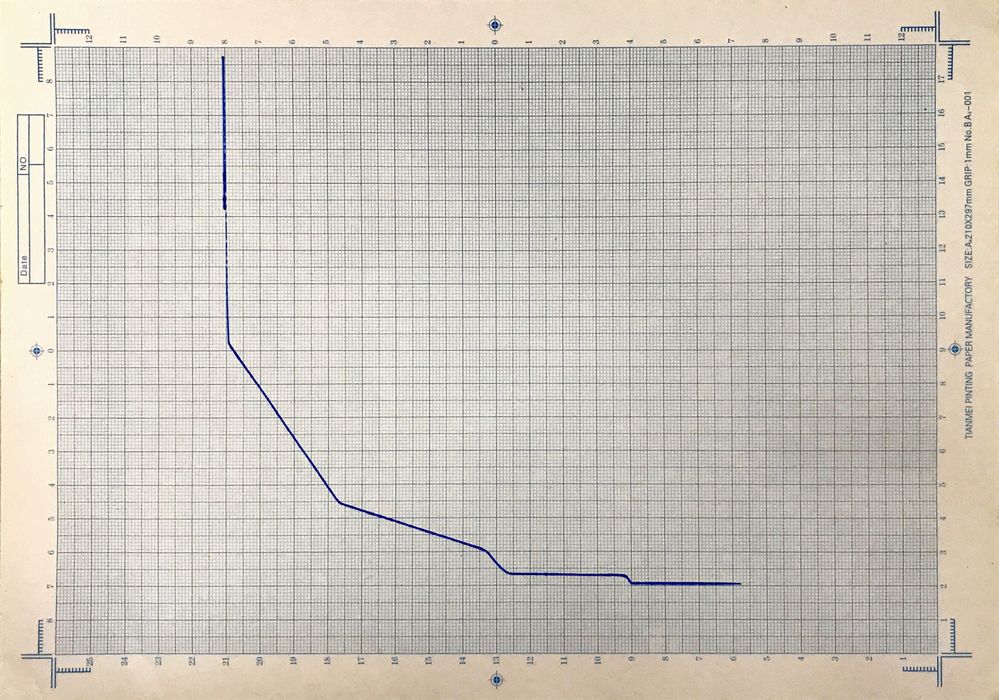

Hi, i am a freshman in labview. but now i have trouble in achieving a DAQ project, which i want to get one XY plot for two signals, one for movement(distance), another for force, and then find the inflection, get the x1-x2, y1-y2,... now i have PCI6221, SCB-68A, and installed properly. i checked the examples on my books for months, but i cannot get the right way. anyone can give me some hints or example for block program, thanks a lot,...... the attached img is a manual paper recorder result, paper recorder result, horizontal for movement, vertical for force,paper recorder result, horizontal for movement, vertical for force,

So you have a set of xy data pairs and there are seemingly two problems:
  • Display it: I assume you are able to graph it on an xy graph. Are you? Why would you show it on a paper graph? How dense is your data? Just a few points or thousands of points?
  • Analyze it:: From a first glance, the curve seems to be composed on nearly linear sections, each described by an offset and slope, and each section well delineated by kinks, i.e. rapid changes in slope. If you would graph the first derivative, these would be dominant steps (and spikes in the second derivative). The slope of the leftmost segments is nearly infinite, so make sure to protect the algorithm from that.
What are you most interested (It is not clear what x1-x2, y1-y2 means here!) Do you want to find all the kink locations? All the slopes?
Are the data values sorted in x or y or all over the place?
Easiest would be if you could attach a simple VI that contains some typical data, then tell us exactly what kind of information you are trying to extract from it. What is the experiment?

actually the curve is simple, just formed by thousands of (x1, y1),(x2, y2),...(xn, yn,), in my case, the horizontal axis x means movement or distance, the vertical axis y means force (you can regard it as a spring force, in fact this case just measure the feature of a mechanical relay terminal spring and movement), each y (force) value corresponding to an x value. you ask how dense the data, now we use a screw micrometer to feed the force sensor manually , so i plan to acquire data continuously, i need maybe 2000 points or more for the whole travel---2 mm or less, should i determine how often acquire a pair of data or how long of movement to acquire? , so the data would be (x1, y1) by t1, (x2, y2) by t2, ...(xn, yn) by tn, OR, (x1, y1), (x1+delta, y2), (x1+delta*2, y3), ...(x1+delta*(n-1), yn), hope you can understand! this is the first step, and second , analyze it, find the inflection point, on the whole graph, normally we have 6 such point, so make a simple subtraction of adjacent point, to find out the feature for every travel.

thanks for you kind response. in fact the curve i need just form by thousand of (x1,y1), (x2,y2),...(xn,yn), and the inflection point here means the intersection(or peak) of different slope.

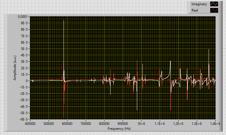

Not sure if this is what you're looking for; however, this is how I create a graph of two data sets (real and imaginary amplitudes vs. frequency in this case) to see data live as we are recording. Hope this helps as a starting point!
This is what it looks like on the front panel:

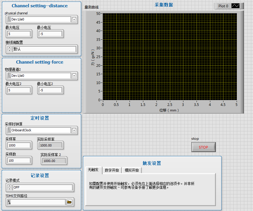

thanks for you example, but it is not compatible, my Labview is 15.0f2, cannot open this file. i will show you the vi and front panel i work out from a "continuous input" example, but it does not work, cannot run, i just copy and add another one channel to the example, em... front panel.PNG
