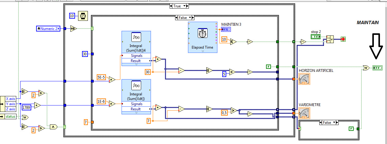

i want to have one elapsed time for 2 indicators,that's my problem.
for each indicator ,there is 1 condition in order to make the elapsed time for maintain starts.i want to have 1 maintain for both of the indicators,so when the 2 conditions happen in the same time(1st indicator  at 30 and the other at 7) then the maintain starts and if he keeps thoses values for 10sec then the user get the maintain
how to do that especially that i have 2 while loops and 4 case structures Smiley Sad

i tried but i think i didn't know how to really use FGV,where exactly to implement it,and what to do to retrieve data from the conditions from 2 loops to put them in 1 elapsed time;so it starts just when the 2 conditions are true

Hello everybody,
Like i already told you in personal messages, the use of the FGV will allow you to detect your events with an event loop.
A way to solve your issue is to build an FGV which gonna work as a chronometer. Different states for this FGV could be
* Set time (where you launch the time)
* Get time (where you get the current time)
* Stop/Pause time (where you pause time)
* RAZ time (where you reset time to 0)
There are several ways to do this, this is a possibility. afterwards, we don't understand 100% your problem because i think you don't know what's yours as well.
We could help you if you are giving us some code to comment, we won't do your code !
Edit ;:
Like a told you several times, your "2 loops" architecture is wrong or your way to develop it, is. That's why you need to start again your architecture.
BR,
Vincent

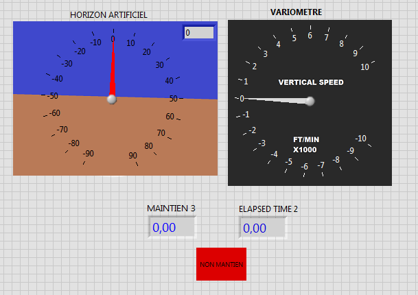

Hi everybody
i tried to use just 1 loop as vincent told me,i think i'm missing just a little thing because the maintain is counting when both conditions of variometre and horizon artificiel are true,but for some reason the moment i reach 7 (the condition of maintain for the right one) the pointer of the left one goes directly to 30 which is the condition of maintain for that one,consequently i get the maintain but it's like the condition of the variometre controls the other condition,how to avoid that
NB:i will try this last solution then i will use FGV .
