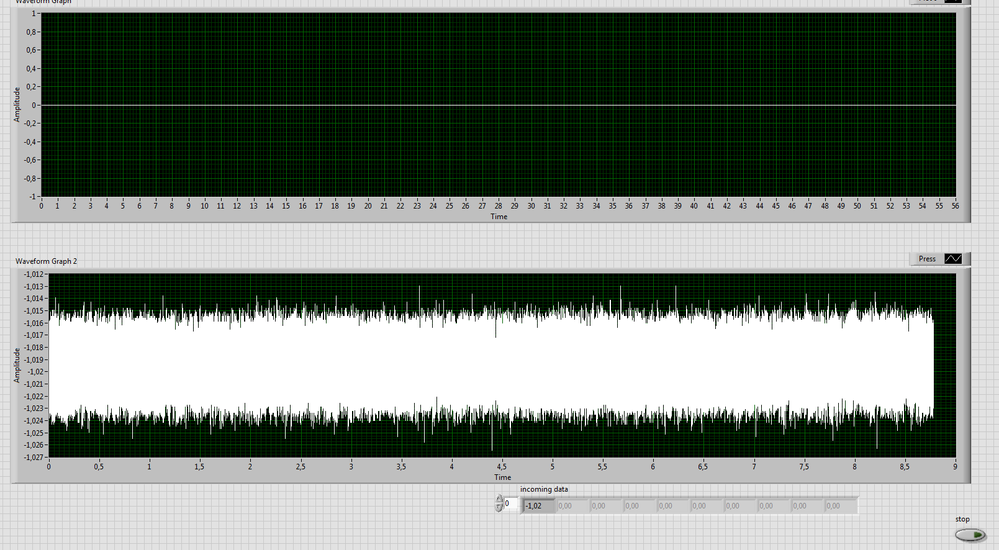

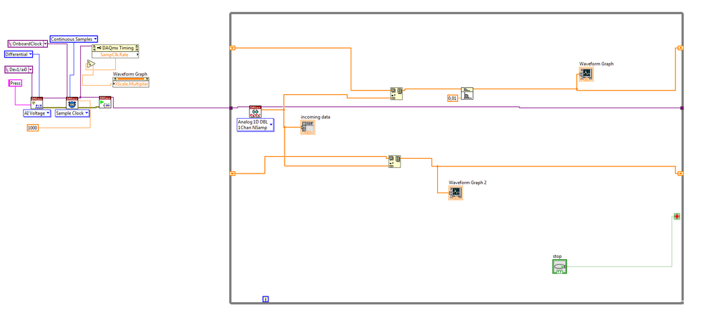

Hi all,
So i get rid of all DDT and made code  easiest at in can be.
Still have problem witch filter it looks like is scaling my value, don't know why.
Co question is where is the problem ? myby filter do not like negative value ?

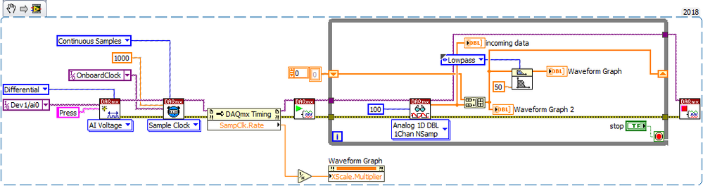

Hi pablo,
No.
See this:
Read a fixed amount of samples.
Set a reasonable lower cutoff frequency!
You still need to improve this VI as it is not recommended to collect (large) data in evergrowing arrays…

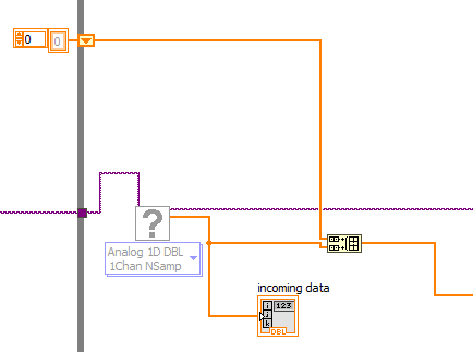

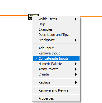

HI GerdW
How did You manage to make this connection? is not working for me.
Message 15 of 18
(1,889 Views)
right-click...concatenate inputs
Message 16 of 18
(1,887 Views)
still not working ...
Edit:
I figured it out
Message 17 of 18
(1,874 Views)
Because your shift register is still defined as 2D array. You cannot concatenate if the two inputs have different dimensionalities.
To fix, temporarily wire a empty 1D array to the shift register from the outside, then set the "build array" to concatenate and things should clear up (There are many other ways to fix it)
