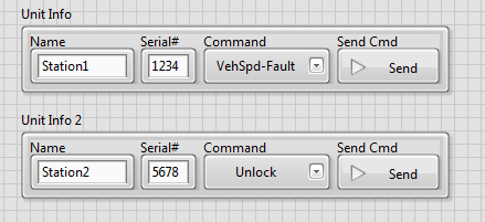

Hello, I'm looking for ideas on the best way to setup an array of clusters with different data contained within the cluster.
Not sure I'm asking the question correctly - I have searched through the forums enough to see that what I am trying to do is not possible - hence looking for ideas on how to achieve the functionality.
Best shown by example:
So this shows the cluster containing 2 strings, an ENUM, and a boolean for each unit.
There might be 50 Units, there might be only 1 unit - unknown at runtime - so I'd like to get this into an array that can be resized as needed.
Trouble is - each unit has different "Commands" - so I am programmatically setting the "Strings" value with the correct commands for that unit.
Well that can not be done inside an array.
So what to do?
Again, just looking for best ideas to achieve this functionality.

Ok, let me explain a bit further..
Each unit is data from a class object and is dependant upon which hardware is connected to the PC.  The "Commands" will vary for each unit depending on what gets plugged in.
I plan to poulate an array with the needed info from the class object; Unit Name, Unit Serial #, Command listing for that unit (Enum Strings), and a boolean indicating wether or not to send that command.
Then I can use the array as a control and in an event case of "Array Value Change", loop through the array unitl I see a Boolean TRUE for sending the command and pass the index to the control loop for the units class objects.
The hard part is getting the strings value for the enum to contain different items for each cluster in the array.  From what I ahve read - it can not be done this way.  So I'm trying to figure out how can I get the same functionality.

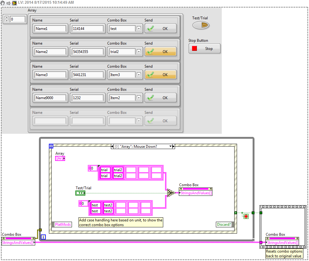

I think the only way for you to do this and keep the output consistent is to use a Combobox instead of an enum and allow undefined inputs. The undefined inputs are required, so that when you have entered in a command from a different command-list, it is allowed even once the Strings list has changed. You can still utilize the dropdown functionality using some clever event structure code to edit the StringsAndValues[]. Try this out:
The default strings and values for the combo box are "Item". When it is running, depending on the boolean control, the dropdown will show different options. The end result is an array of commands from different dropdowns.
You do have to be careful with this because somehow you need to tell your code down the line which command list you are using. If you have the same command name for two different "units", then your code may get confused.
