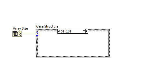

Hi pals,
You could try using case structures shown below, with an array size going into the decision terminal.
So if the array size is from 50-101 then execute so many checkboxes...
See the picture below for the code to do so!
John McLaughlin
Academic Account Manager
National Instruments UK & Ireland
Message 8 of 13
(3,938 Views)
Hi John,
Problem is that if i use Boolean as ref then only i will get property node as boolean text. text.But for 100 Boolean tick i cant make 100 Boolean ref and then convert it into cluster as in array again i cant give different names to different boolean tick. So i am facing problem in the initial steps only. if only one boolean tick then its no issues but in my case there is no fixed values... hope i am cleared to explain my problem.
Pals
Message 9 of 13
(3,932 Views)
