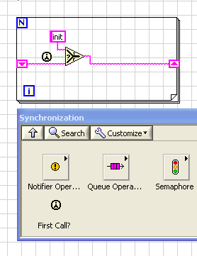

Can you put the shift register on the outer while loop?
Rhys
Message 2 of 8
(3,994 Views)

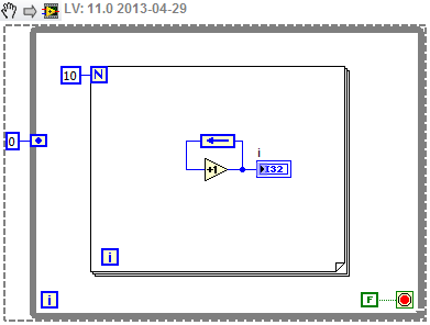

A nice solution I use for this type of situation is to replace the Shift Register with a Feedback Node, and move the Initializer out to the outermost loop (or wherever you want it).  So it would look something like this:
This saves on running wires through parts of the code that don't need to know about this value.
