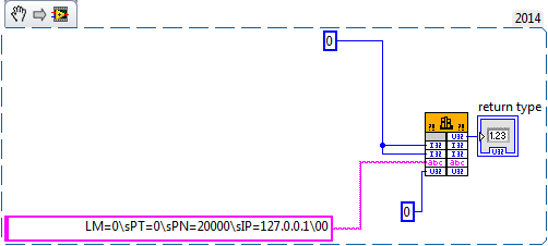

I'm sorry for posting image wrongly...
Here i tried to pass some parameters to my function but it doesen't work correctly.
Can someone help me?! I don't know where i am making a mistake
Thank you very much
Giovanni

You are talking about a  PviCom.dll:PviInitialize as "your function"  , I don't think anyone will be able to help you with this without the dll.
I would suggested you check the manual that comes with the dll and an example of how it's accesed.   Your vi looks ok.

Yes!! Smiley Happy
I am talking about PviCom.dll, in particular PviInitialize function...
In atteachment there is the declaration of the function and also an example. I think i am not making mistakes... But i can't understand why labview returns me error 1517...

Because labview gives me the error 1517 meaning that there is a mismatch between function of the dll and parameters that i pass to the function...
Message 8 of 10
(7,140 Views)
Two things then:
1) Are you sure your function uses  cdecl and not stdcall?
2) I assume you run in 32 Bit LabVIEW but if you ever plan to use 64 bit LabVIEW it would be better to define the last parameter as pointer sized integer instead.
Rolf Kalbermatter  My Blog
Message 9 of 10
(7,132 Views)
You are wright!!!!!
The problem was that i used cdecl and not stdcall... Using stdcall it works correctly.
