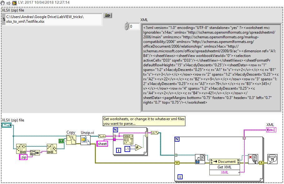

This snippet can you get started. Of course, you still need to program the xml parsing part, I never did it, but I guess it is not that difficult...
