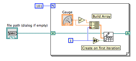

Error 43 results from the user hitting the Cancel button on a file dialog.
Your use of the shift register is appropriate. You may want to make the the append to file input False on the first iteration and True on all later iterations so that it creates the file when the VI starts and then appends to it on subsequent iterations.
Use Build Array not Build Matrix. In LV the Matrix data type should only be used when performing specialized linear algebra operations that do not work on arrays.
For fixed number of iterations use a for loop rather than a while loop and a comparison.
Lynn

Attach an image of the block diagram. I'm sure you did not use the shift register correctly.
Message 24 of 34
(1,617 Views)
I attached the image.thanks
Message 25 of 34
(1,613 Views)
You didn't wire the shift register to anything. Look again at Lynn's example.
You really need to take the free tutorials.

Accepted by topic author Eram
As Dennis pointed out you did not connect the pieces and parts as I recommended.
Lynn
