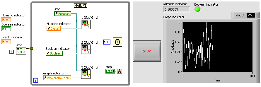

my program has many sub VIs, i wish to show in the main front panel the progress of each sub Vi; what is the best way to do that?
atleast i need to show that each sub vi is completed, [can i add details on the main front panelsuch as: filename that is being read by a subVi, graphs plotted by a subVi, etc..]
can i display a graph from a subVi on the front panel of the main Vi?
what i hv done is attched as picture.

Is the progress or status of the sub-vi's shown in the circles?  ie: above Date wise VI?
If the circles are controls (Silverlight boolean), then you could pass references of those booleans into the sub-vis.  You could change from True or False (red / green) or change the color of the control to perhaps yellow, blue, green red, etc to show status, using a Round Color box found in the Silverlight palette.

as suggested...pass references and cntrl references
Spoiler

@Ray.R : yes only the status of each sub Vi is shown byt ht circle LEDs

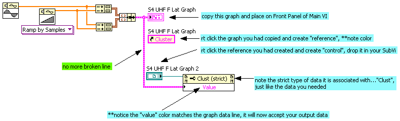

@apok: what u showed is great and was what i needed, thank you for the reply 🙂
but i face a problem in my sub Vi when i try to do the same
the "property node" is used with a graph in Your Vi but in my Vi i hv an XY graph plotting clusters..
am getting this error
"You have connected two terminals of different types
  Type of the source is cluster of 2 elements
  Type of the sink is double   "
image attached is of the sub Vi
what should i do to get this graph in my main Vi ?

You are trying to wire a cluster of 1D array to a 1D array.  Maybe it sounds less confusing if I say it backwards...
You are trying to wire a 1D array to a cluster of 1D array.

follow example....from your example: it looks like your explicit property node wants a (dbl) data feed Smiley Surprised
Spoiler

@apok: thanks a lot for the reply, i did it 🙂
