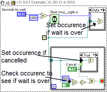

Here's another possibility using OpenG Wait ms:
Ton
