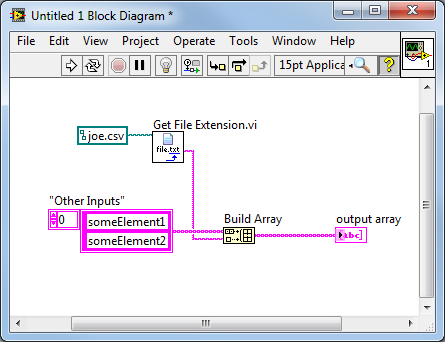

I assume you have an array of strings. You can strip the filename using get file extension. You can build an array using build array. Wire the existing array on one input ant the string as a second input.
(8,133 Views)
I would also ask you the same questions altenbach did, and here's what he was saying. Hope this helps. Cheers

If you are starting with a string, and not a file path, use Search/Split String and search for a period.  This will split the string in two.  Place the file name (minus the extension) into an array using either build array or Insert Into Array.
You also might want to give some consideration to the order of names in the array (maybe sort them?)
