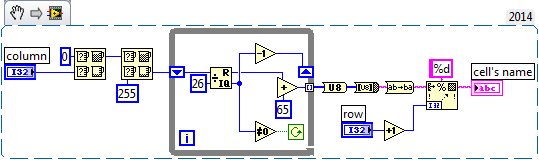

Please use report generation toolkit.
Here is the snippet from RGT.

thx!
I created one before, but yours is great!
