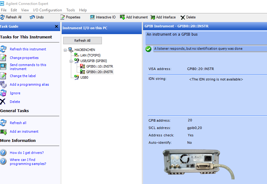

                                                                                       Agilent IO can find HP3562A
                                                                                           MAX can find HP3562A

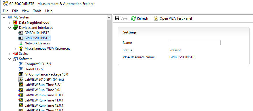

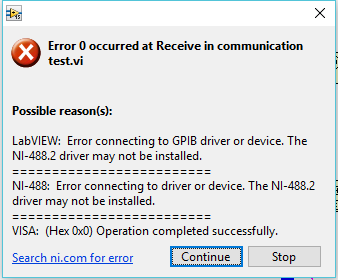

When I run the program, the error 0 will happen. I also put the picture from MAX, I already installed the driver (actually I installed all the drivers just in case).

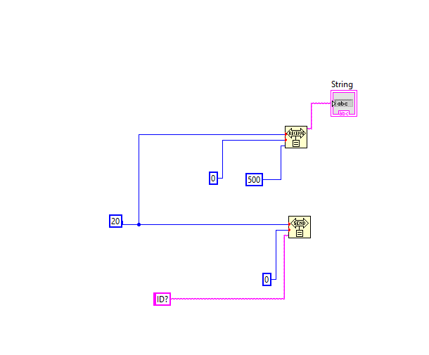

But the way, I also have a old computer with labview 5.1. It use PCI-GPIB to connect with HP3562A successfully. Below is the part of the program.

Hi Peter,
don't use those old and obsolete GPIB function anymore! Use VISA instead!
You use an Agilent USB-GPIB-converter: this part of hardware does NOT cooperate with those old GPIB functions. They are mainly made to use NI hardware. The VISA functions instead are more versatile and can also communicate with (properly installed) 3rd party hardware…
Additional notes:
Why are there so many coercion dots in your VI snippet?
Why is there no explicite DATAFLOW in your snippet?

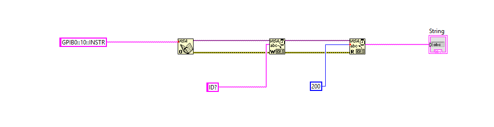

Thanks for you suggestion.
I use VISA functions to simply write another program.

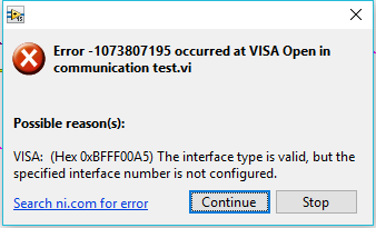

But when I run it, it shows

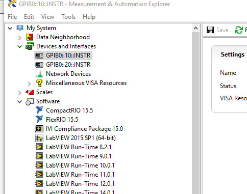

But is MAX, it already can detect GPIB0::10::INSTR (33220A). I am thinking that it can show in MAX means that it was configured by Lab View.

Continue that conversation in the thread you already started on that topic.
http://forums.ni.com/t5/LabVIEW/The-pop-up-menu-of-VISA-resource-name-comes-nothing-except/m-p/33518...

In order to use the Keisight hardware in LabVIEW or NI-MAX you have to configure the VISA software properly to use NI and Kesight VISA drivers.   Please refer to this solution - https://forums.ni.com/t5/Instrument-Control-GPIB-Serial/Agilent-usb-GPIB-82357B-is-not-shown-in-NI-M...
Before you start make sure you install the latest version of Kesight I/O library supported by your OS.  Then follow the steps in the documentation linked to above.  Then reboot, even if its not mentioned..
Craig
Message 7 of 8
(4,181 Views)
For HP/Agilent/Keysite USB-GPIB you need to make sure the NI-VISA Passport for TULIP is enabled (it is disabled by default)
