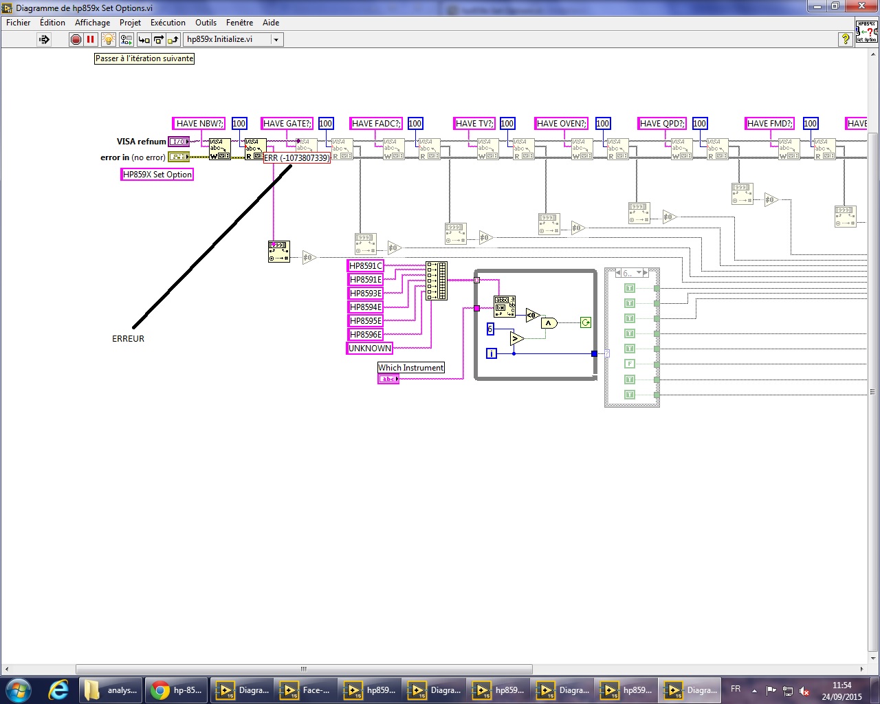

I am working on the HP8590A and i would like control my device with labview's interface. I have some problems with the drivers for HP859xx. Indeed in the Vi SetOption, fault occur with the bandwith (The command HAVE NBW? does not exist in the manual).
So if people could help me with my problem to control the HP8590A it will be great.

Hi kyophys
Can you upload some screenshot about the error and the values that you select in the Front Panel.

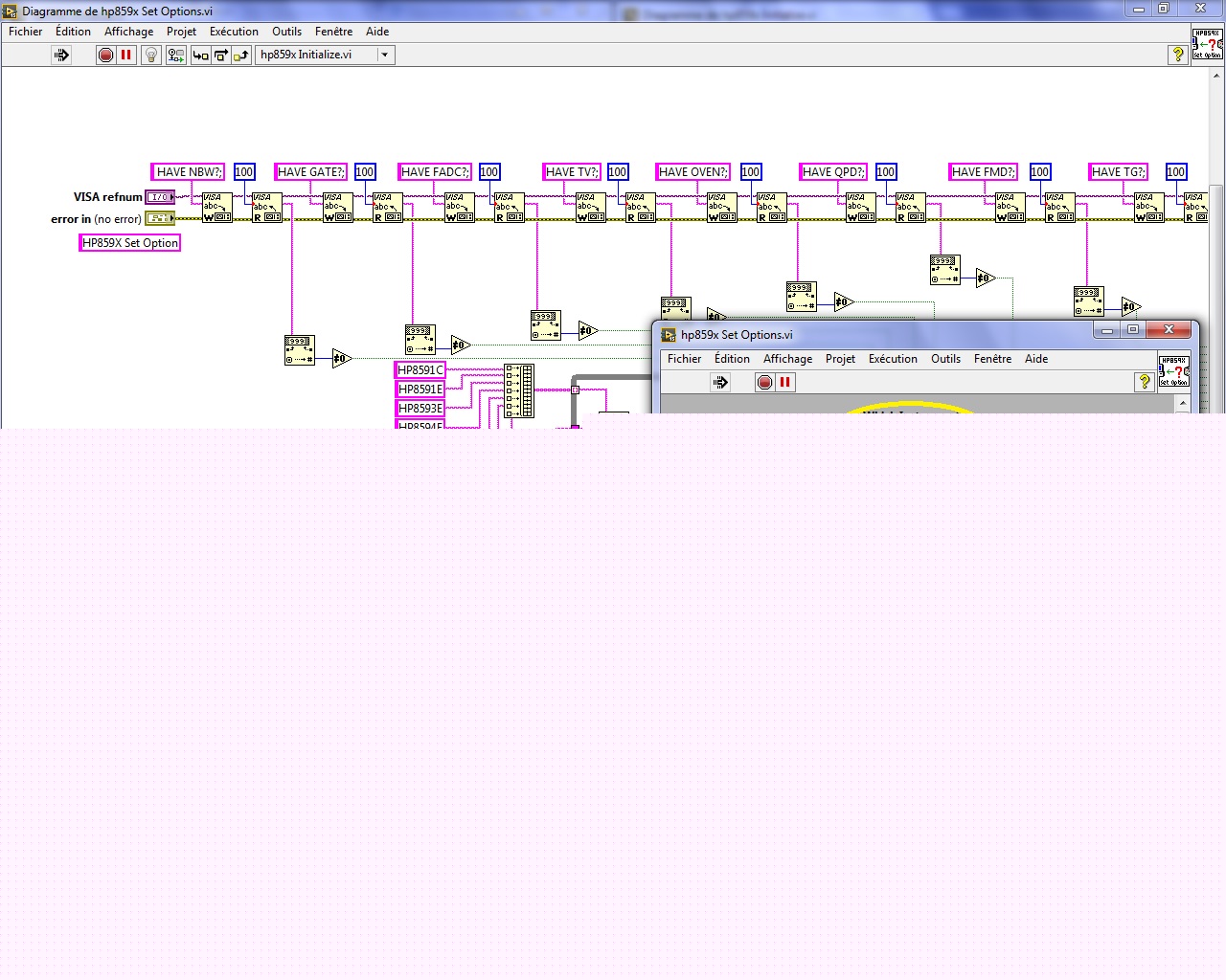

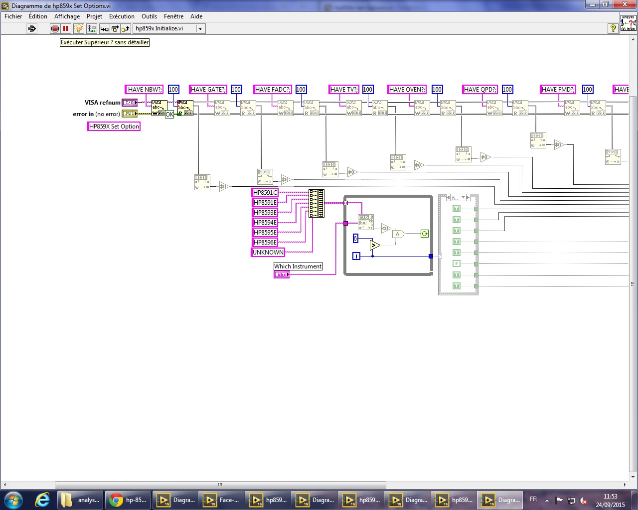

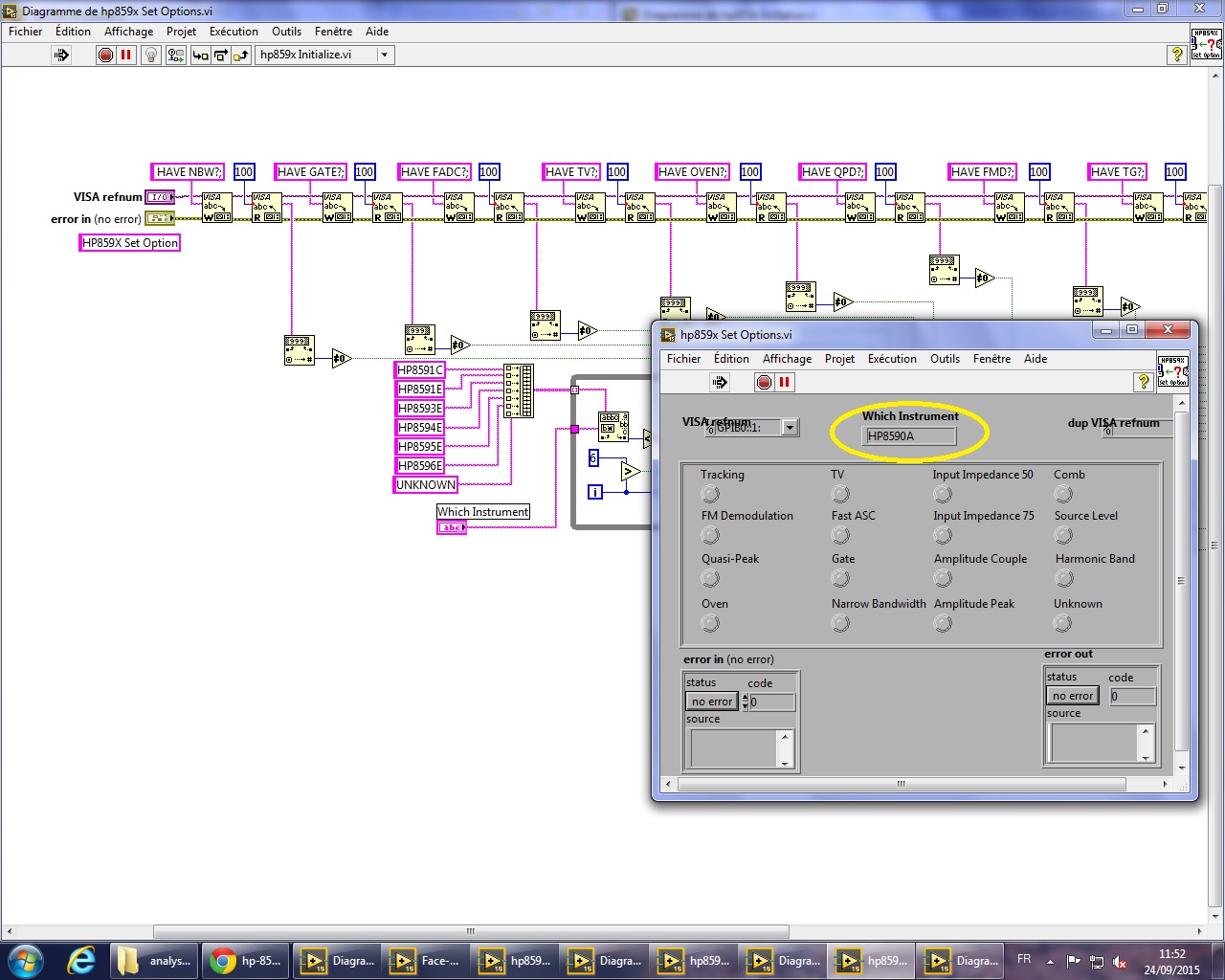

Hi David22JRA (I am Benjamin (Kyophys));
I send you some pictures about my problems. (1)Initialize.jpg(2)SetOptions.jpg(3)SetOptions.jpg(4)SetOptions.jpg

Edit the VI to remove the command if it doesn't work. You tested it in MAX?

For the HP8590A all comands in this VI doesn't work, they are not in the programing manual. So I think I need to delete this VI beacause it does not work with my instrument
