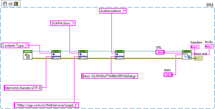

Have you tried using the header name for the header input and the value in the value input?
That way LabVIEW can add the colon for you and you should not end up with an extra colon
For example:
Milan
(7,016 Views)
Thanks a lot!!!! This is what was needed
