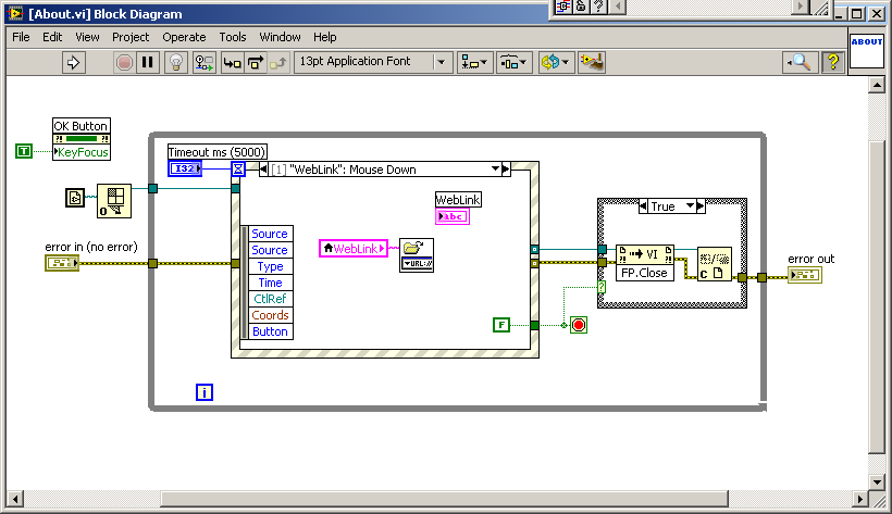

You can use a string indicator and the Mouse Down event to open a URL using the system's default browser.
Example "About" box VI with URL below (LV 2012)

Sorry, didn't see the 2009 in your post. Attached as LV 2009
