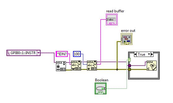

i control the agilent device. i used VISA lock.   then my computer shut down without unlock the session or close the sesion. then i open the computer again. how can i unlock the resource?
i locked the device like this picture. when i clicking the boolean for close the session(unlock the session), i couldnt do this because of my computer shut down. and then i open my computer again. i tried to connect the device again with VISA. but error returns. error: −1073807345   description : Specified type of lock cannot be obtained, or specified operation cannot be performed, because the resource is locked.

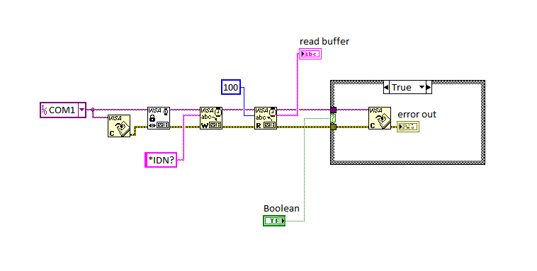

Close the port at startup the way you are doing at the end. So every time you start the program the port will be closed first and then you can open and use it again.
This should solve the problem unless someone else is using it. Give it a try.......

If you try this, what error you are facing?

Hi All,
Miraz, when i tried your said, i face tihis error; -1073807345 (Specified type of lock cannot be obtained, or specified operation cannot be performed, because the resource is locked.)
