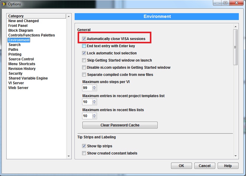

also it is better to know this option in your labview and use it
it is help ful when you do not finished your visa programing and need to run your code in several mode

Hi, Hatef.fouladi
thank you very much.
long term automatically close visa session  is good idea.
but short term, how to solve the visa locked issue?
I don't find out the root cause and solution.
do yo have any idea about this issue?
