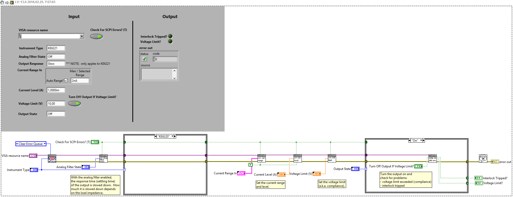

Ok, I managed to get the driver via the German website of Keithley, I have attached it, unzip it into your instr.lib folder!
Here is one example VI, try to use it (C:\Program Files (x86)\National Instruments\LabVIEW 2015\instr.lib\Keithley 622x LV 2009\Examples\KE622x -- Setup DC Current Source Example.vi):
