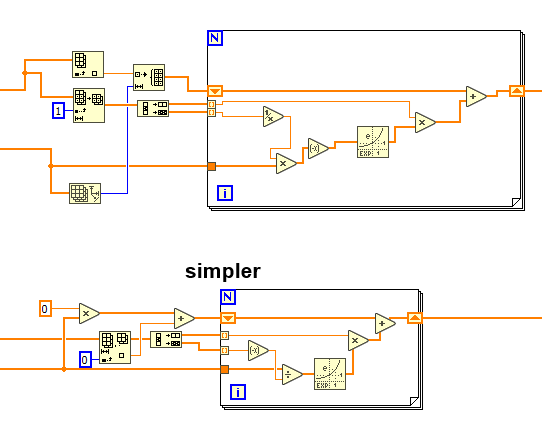

@TheWolfmansBrother wrote:
They provided a .txt delimited file in a previous post. Thanks for your input.
Obviously, the OP Wants a double exponential with an offset (T1, T2, A1, A2, Y0), so we would need a general nonlinear model.
For the single exponential fit you did, here's a slightly simpler version (Assuming X is sorted)
(I did not understand the bottom part of your code)

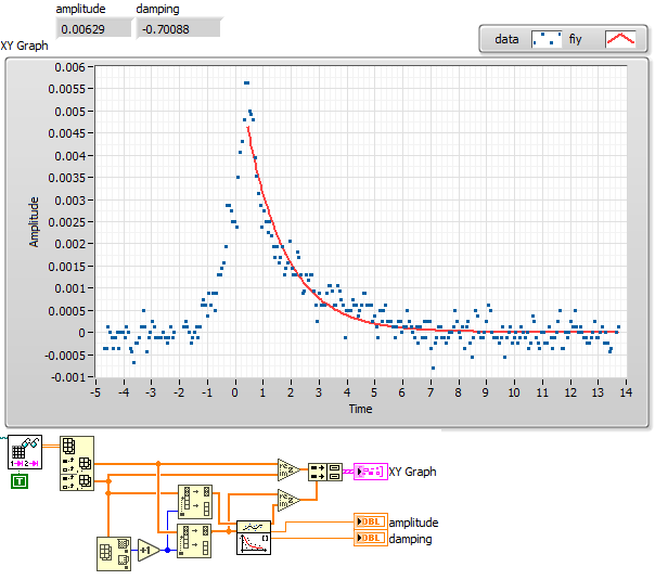

run "CodeMadnessFitting2010\FitCurveSelect.vi" (labview 2020) from attached .zip file
it looks like the simple expontial fit is almost as good - in terms of residues -  as the double expontial fit, if the data is constrained to >=y0, and y0 is found as the global maximum in samples.txt

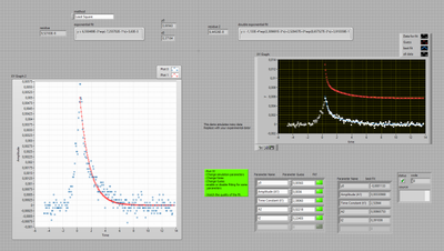

I’ve recently started learning LabVIEW, and all the answers seem difficult. I tried to simplify it, but it still feels challenging. What else should I do here?
Message 13 of 20
(460 Views)
Does it work?
  • As a first step, you should make the initial guess control have reasonable defaults. An empty array is not reasonable. The guesses should be reasonable for the already given data so we don't need to guess.
  • Don't make the front panels gigantic with lots of whitespace.
  • You have not implemented the search for the valid data after the max value. Most likely this program will not work for your original data.
  • In the model, it is less work to negate the 1/x scalar instead of the entire array later. N times less work!
  • You can get the first element and an array of the rest by using "delete from array".
  • Don't call the best fit parameters indicator "best fit". The best fits is the output above it.
  • Do you fully understand the code?
You told us in Message 3,that you want to fit only the x,y data points withs positive values
The best way to prepare your data is to use altenbach's suggestion from Message 11
also, messages 3 reveales an initial guess for {offset, amplitude1, tau1, amplitude2, tau2} which works fine if the datapoints to fit are limited accordingly.
Message 15 of 20
(412 Views)

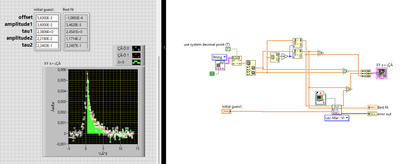

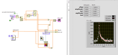

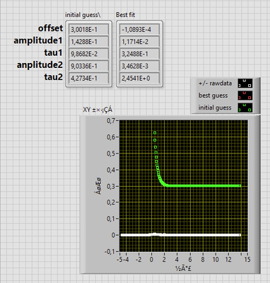

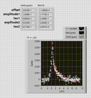

@dlehdgh20 wrote:
Is it possible to automatically set the initial guess in LabVIEW?
for curiosity, I tried to initialize with random values, and the regression will converge to a usuful result. apperently.
Spoiler
init best
Message 19 of 20
(308 Views)
@alexderjuengere wrote:
Yes, the algorithm is quite good and forgiving. Good initial values still shorten the convergence AND increase the success rate. It also depends on the model, some are more forgiving than others, of course.
These random values (0..1) are still very reasonable here. Try random vales in the range -1e6 to 1e6 (i.e. make the sign random).
Also, the two exponential components might switch place and it would be useful to later sort them by damping factor or amplitude if desired.
Message 20 of 20
