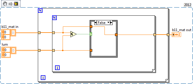

Hi Fairy,
I think this is basically what you are trying to do with your code.
The case structure is generally a pretty good replacement for the if statement.
You can find a little more about the case structure here.
The other neat thing is the for loop automatically indexes through the arrays for you.
Good Luck,
Brett

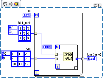

I think Gerd has shown you very effective code for your request,
here I just add the possibility to control the value m and n.
regards,
Yan.
