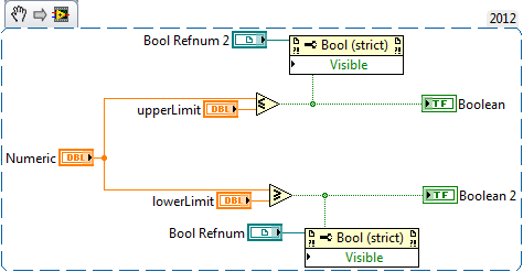

Thank you, your answers came closest to what I was looking for. my internet survey did not help so I tried it here. I was looking for a general/common approach for showing a specific out of range case.
I guess I will implement it with two "leds", one that is green if the value is above the lower limit, red otherwise and the other led being green when the value is below the upper limit and red otherwise. Or I will add a textfield saying "in range", "below lower limit" or "above upper limit". The latter two cases in red maybe!
Message 13 of 22
(1,482 Views)
If you place one LED directly on top of the other and make one of them transparent when the other is out of range, you can simulate a 3-color LED. (Make the "off" case of the upper LED red and the lower LED yellow, and the "on" cases both green, for example).

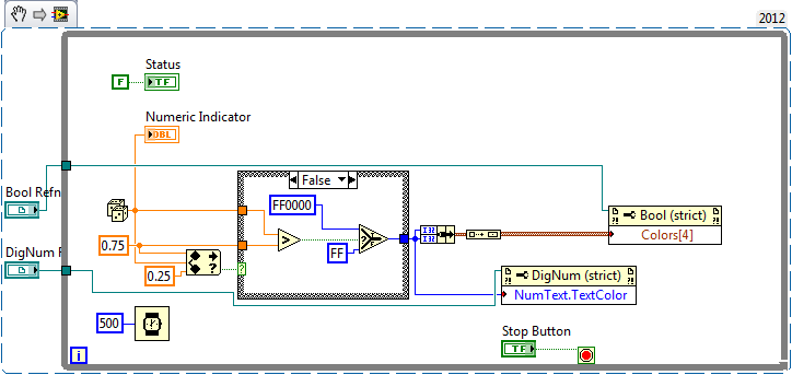

Why have two indicators when you can just change the colour of one using the same structure? 🙂
Edit - the bundle and build array exist because Boolean controls have two colour properties (FG and BG) and up to four states - true, false, true-to-false, false-to-true.

Gerd - the real benefit is in using the nested case structure to allow expansion of the colour output. What you choose to do with it is up to you. You're right, wiring a colour box indicator directly is the better way of doing it, but I originally suggested the OP change the background colour of an indicator (or the text colour) as a way of keeping a single indicator.
Creating multiple indicators and then hiding them seems more work to expand and adapt.
There's more than one way to skin a cat though 🙂
