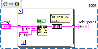

There are some nice solutions already posted above, here's another random one. 😉
Message Edited by altenbach on 04-16-2010 11:46 PM
(9,412 Views)
